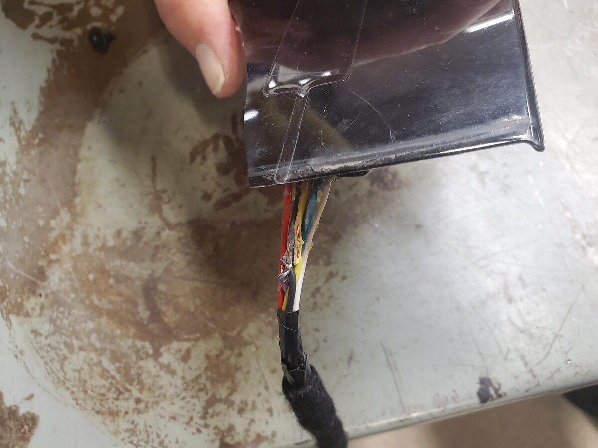

2017 ford explorer drivers door keypad flashing, causing battery drain.
we had a 2017 explorer that occasionally had a dead battery,and if not dead intermittent extended crank then the driver noted that when she would walk up to SUV the drivers door keypad was either on or flashing (all the #'s and the red l.e.d above the keypad) after spending many hrs. on diag. pulled drivers door panel off and disconnected the keypad, pulled trim panel off an found wires for keypad chaffed where they entered the door. replaced door trim w/keypad. no more flashing. 2 weeks later and no dead battery or extended crank when starting.
hope this might help, i didn't see any fixes for this issue
mike

Great post! So you fixed the wiring and the keypad is working again? Mine was doing this and now is completely dead. Appears to be a bit of work to get to this so I've started to live without the use of the keypad. It sure is nice to have.
I see this is old but we had same problem killed battery took ford 3 weeks to get in for diagnosis. We are told there is a plastic clip inside that breaks causing the computer to draw energy. Of course this happens after warranty ends just to be clear I have 37k miles and it happened so it's not covered. It cost 791.00 to repair with no guarantee it won't break again because it's plastic. Called Ford corporate but again no help there since its not under warranty and has no recall despite thebtech at service saying they see this a lot!!!. Great customer service Ford!!!
