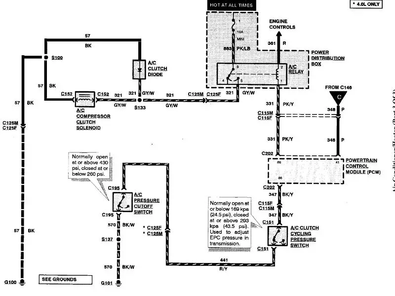

If your cooling system fan clutch is going bad, it's probably slipping at low RPM's, this should have nothing to do with low-side low pressure though, if the pressure cutout switch has been jumpered, that eliminates that part of the circuit completely. What bothers me and has me stumped, is why the A/C clutch isn't engageing at lower RPM's. I know the PCM senses when the A/C switch is turned on so it can raise the RPM's slightly to compensate for the additional load. I think that area is where your issue lies. Start with looking for a bad A/C relay, it's in the power dist. box under the hood, behind the battery. There should be some big fuses, some fusable links and 4 or more relays.
Thanks Fixxxer.
My instinct had been in that direction - that a relationship between rpm and fan clutch is out of whack. That the "conversation" with the PCM is off. I'll look again at the a/c relay, but I DID look that way when my a/c was first acting up (due to the clogged orifice tube).
One thing that I think adds to the analysis: When I turn on the a/c, I DON'T see the expected forced rise in rpms. In fact, the rpms, at idle, will DIP from around 700 to around 400-500 or so, every time the compressor fan clutch engages. That's what gave me the idea to override things and rev the engine on my own - which DID get the clutch to engage.
Honestly, I'm hoping that replacing (rather than just cleaning) the IAC will set things right. But that's only because it's a simple, and relatively inexpensive fix. But I'll need to reexamine your shematic (thanks for that!) to figure out if the IAC is even in the electronic loop.
