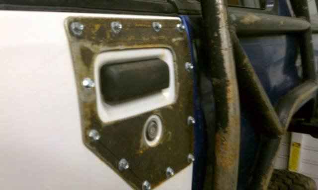

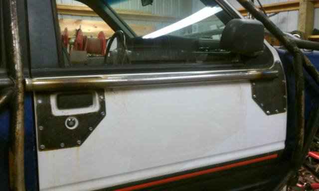

Still working on the door bars, should help transfer some on the impact to the door jams and not the glass... we will see.

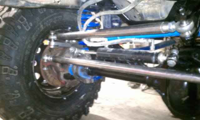

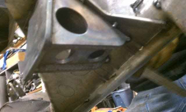

I ended up going with 1.250 heims (same as my duff radius arms) with .250 wall dom tube for the track bar, all the mounts are .250 also, Im sick of messing with the track bar after every other trip so I figured I would way overbuild it this time. The last one had a bend to clear the diff but thats where it bent the last few times so the new one is straight. I had to move it way up to clear the diff when everything is compressed. Another problem I have to figure out are the bump stops, the drivers side will have to have a striker plate right off the side of the diff to hit the stop...
Those door bars are amazing! So simple but it will totally work. I am going to copy you since my door is cut in half and I am on my 3rd set of doors. I don't want to look for another set next year.

Track bar mounts and bump stop plates...

more track bar mount and bump stop plate...

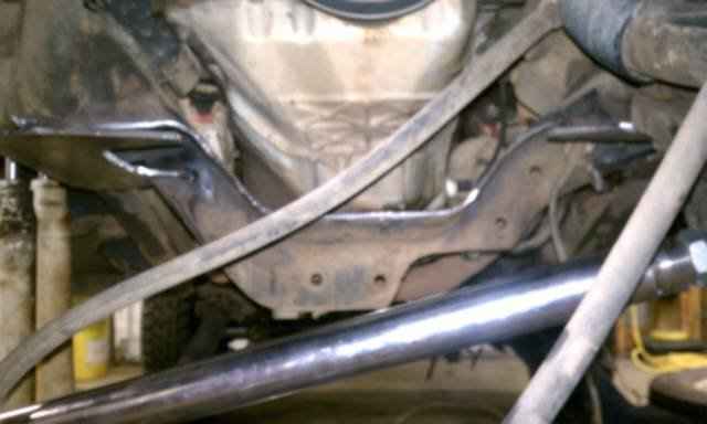

had to remove alot of the cross member to clear the track bar now that I raised it up so high

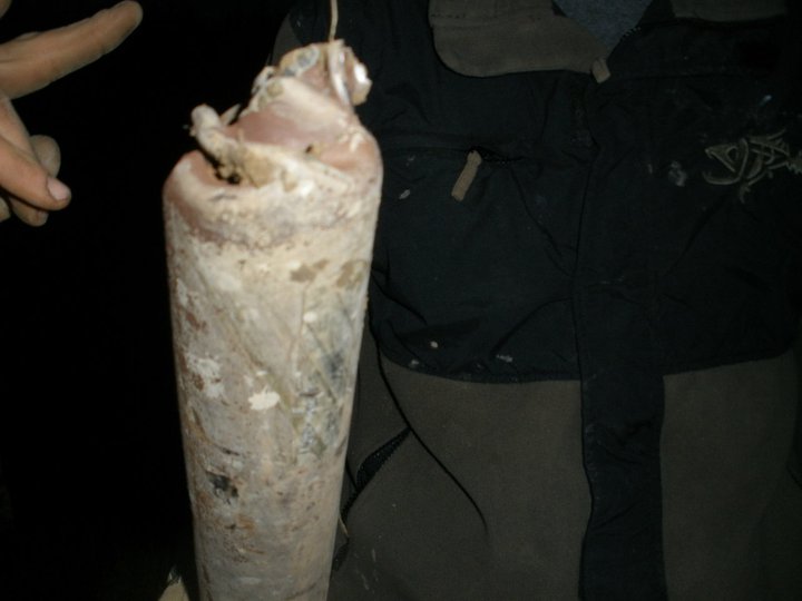

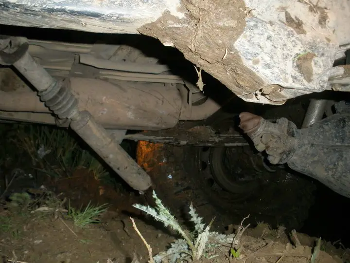

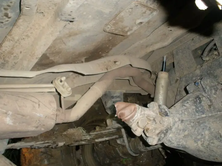

Well, it didnt take long to find the next weakest link... transfer case and driveshaft.
Atlas time?
More fail... I have beat that t case for 3 or 4 years so Im gona try another 1354 and see how long it lasts. I think the doubler shortened this ones life alittle...I-5 has them for $100 so I have to destroy alot of them before I buy an Atlas but we will see.
