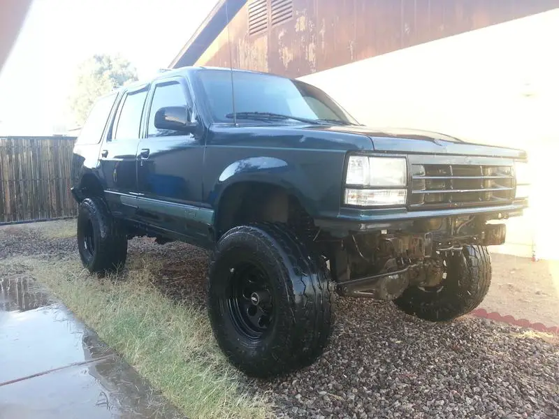

Whats the difference in how they work? was just reading up on another post that they recommended skyjacker because they have better clearance witht he way theyre shaped. i might have to take a look at the JD arms now :D oh an p.s.! could u post a pic of your rig with the 33s on it? Still debating myself between 35s and 33s wanted to see how 6" lift looks with the 33s
5.5" Superlift with 33x12.50 tires on 15"x8" Crager Soft 8 rims.
