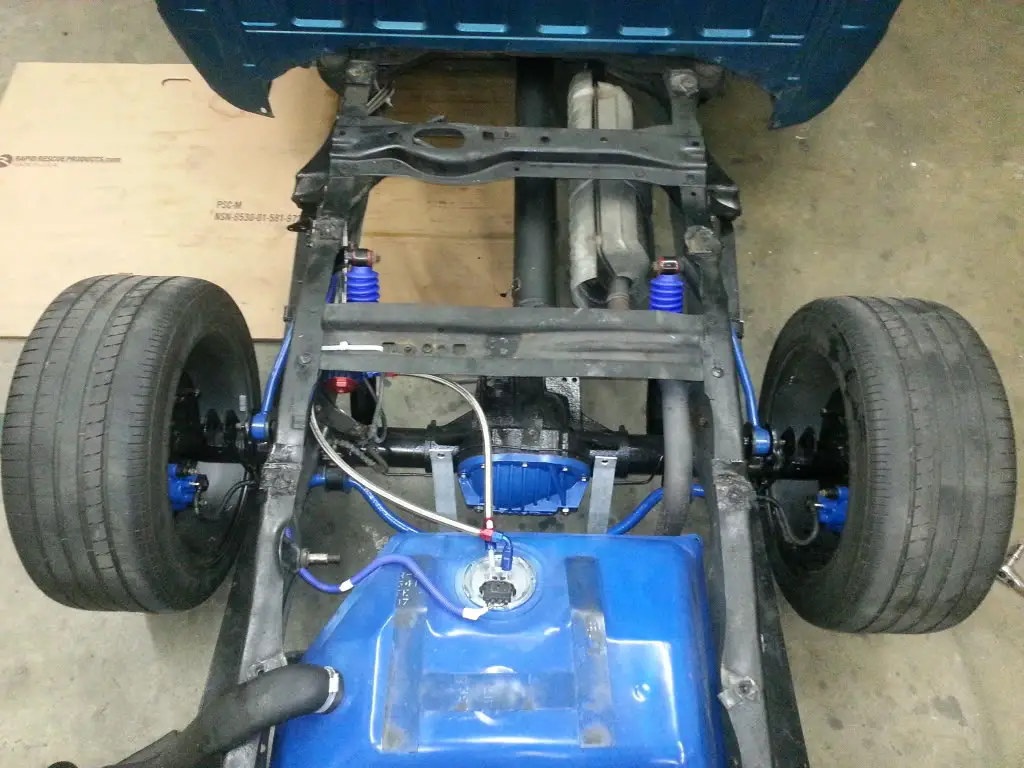

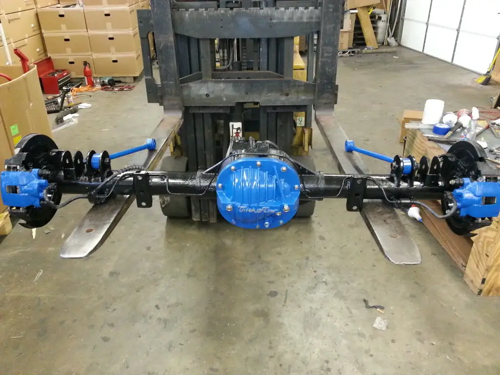

I wonder if they could be adapted to a '93 Ranger, and if there would be any benefits?
You mean like this↓↓↓↓↓↓↓ you have to move them inward from where they are on a ex tho.ranger frame is narrower. Big benefits over stock.I cut my mounts on the plasma table, same specs as stock..o only will work if your spring under tho..if your spring over its best to just run the james duff ones..
oooo, pretty!
Cool. Are the mounts themselves still available new? (Especially the frame mounts) Is it me or do those links look an awful lot like the stock swaybar end links (for a '93 Ranger)?
Cool. Are the mounts themselves still available new? Is it me or do those links look an awful lot like the stock swaybar end links (for a '93 Ranger)?
The mounts you will have to get from jy.check edit also..you gota be sua for them to work otherwise its best to run james duff bars...end links?? Which ones? Thats a 98 5.0 explorer rear end, leaves and sway bar.it uses jeep sway bar end links and was totally rebuilt with ford racing parts;)explorer sway bar links wont work,too wide/offset and long.and thats a B2 gas tank:salute:

What about a "wrap around" mount, for SOA, where the mount actually attached to underside of the axle tube, but then wrapped around the whole tube/spring/spring plate, so the link itself was still attached in the same position as yours? Would that work, or would the physics be different?
93 rangers dont come with rear sway bars(edit I guess they do...its a very rare option, that pic from autozone looks to be same as a explorer link).most people run a b2 sway bar..
I cant visually see what your referring to.they make so many different ways of attaching bars tho.I know the jd ones are cheap and direct bolt on..or you talking about sway bars not track bars?sorry its been a LONG 3 days..:(
