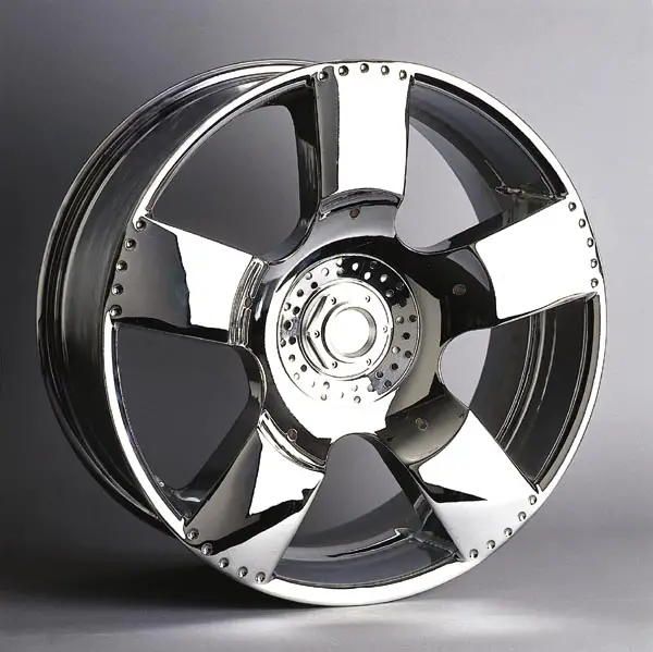

just get these
what kind of wheels are those?
not tellin'...
kmc thunders
Those rims may look ok on some Explorers, but personally I don't want chrome wheels.
