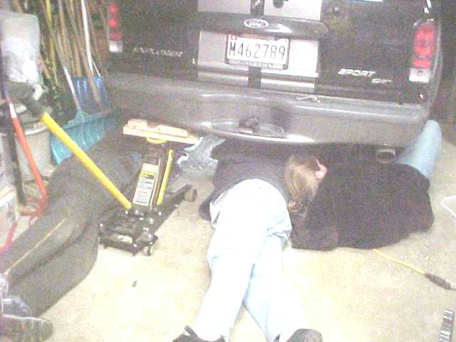

So, uh..How many Explorer owners DOES it take to install a rear sway bar? ;) :D
Much thanks to ExplorNJ and his pal for managing to work the bugger around my big ol' spare tire :)
Truck handles GREAT! Very little understeer now!

ummmm, might I ask why u are jacking it up BY THE BUMPER ?????? lol
doesn't look to safe to me. LOL
I was tired when I posted that-sorry I forgot to explain...
ExplorNJ's garage sits on a slant and we were having a heck of a time getting the bar ends to line up with their bolt holes, so we put wheel chocks under the front wheels and jackstands under the proper lift points and used the hydraulic jack to lift the driver side up a little higher. No damage to my bumper since we used to pieces of wood to cushion it from the jack.
LOL- Come on, you guys think I'm crazy enough to get crushed my own Explorer? :D
never know with you, your truck might get mad and fight back :eek: :confused: :D :p
Isn't there a tow hook there on the sports? Looks like you put the jack under that.
you never said any thing about a picture with me in it, at least you got my good side :confused:
DAMN - seems like I did it the hard way.... all by myself on the rear. Though I snagged some help on the front :)
But boy was it worth it - those bars really do make a difference!!
I was working on an Isuzu Trooper today, and the swaybars on that thing looked like pencils. No Joke.
it would have been a one person job if the truck was on a flat surface but the truck was sitting alittle lower on the driver side so we had to jack the one side up to make it sit the way it is supposed to
to explain a little about this,........it is not a hard job on the ground. Since the job of the sway bar is to stop the bocy of the truck from swaying back and fourth wen u corner hard, you need to "un load" the suspention of the truck. You simply leave the truck on the ground and jack up the BODY to take the weight of the suspention. If you dont Un load the suspention it will be hard to bolt it up. Since we did Spas's truck on an un level drive way. we put the jack uncer the tow hook on the side that was lower. If you do it on a level drive way you would want to put the jack in the center of the truck.
