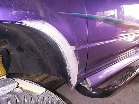

What I did is take the 3" wheel grinder and made the cut were I wanted the finished fender to come out to. If you look in the picture you can kind of tell how far up we started the cut. Then it went back about 3" I think or to the middle of the two holes on the bottom of the fender.
Once you cut a line in the fender (DON'T CUT IT OFF AT THE TOP) the little sliver that is left is tucked back behind the fender which will leave your original edge for your fender. I might have more pictures on my web site you can look at. I don't remember.

This is what it looked like afterwards until I bent up the nerf bars and had to add rock sliders.
As you can see you don't loose the look if you save the edge. I forgot you have to weld the fender back up about 1/2" from the edge and then bondo a little.
Oh yes we did have to cut the little piece of tupperware down also. Dad cut it down, then he used some metal strapping and rivets to hold them together. Looks just like factory if you ask me.
