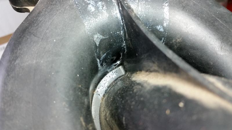

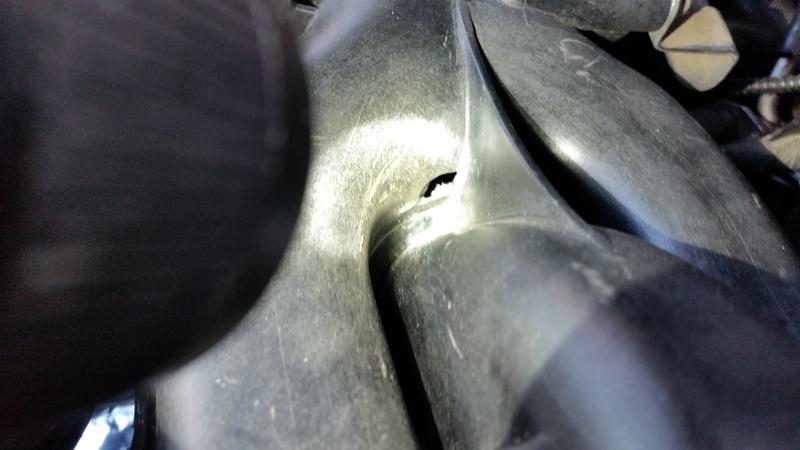

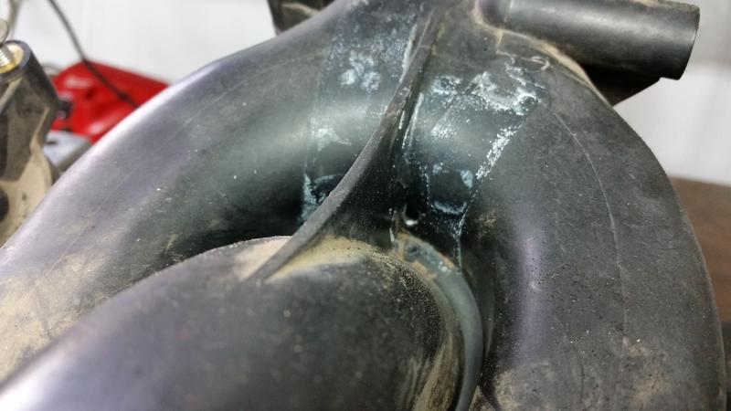

Let me give yall a little backgraound into why I did the timing chains on my parents explorer. It started because while my brother was borrowing their explorer it started running rough, come to find out the orginal manifold had two holes in it as you can see in the pics
I found a used intake manifold that was in good condition I looked it over before I purchased it. Their was nothing wrond with it. I was in the process of changing the manifold when I decided to change the valve cover gasketss and noticed that the rear timing chain loose and I could move one of the cassette arms.
So here we are I got this thing put together, it was running great no rough idling it was purring. I let run for at least 30 min before I decided to take it for a drive. While I was driving it I could hear a hissing sound, I thought maybe I left a vaccum hose disconnected. I also notice that when I try to accelerate faster than normal it doesnt want to shift like it should. Go back home look it over cant find nothing, but I do here a leak of some sort it sounded like it was coming from the driver side near the transmission.
I take it back out same results hear a hissing sound and doesnt shift normally upon acceleration. As I get down the road from my house I notice that its starts running rough the hissing is more noticable and as I park it wants idleing roungh. Pop the hood open I here the leak its at the intake manifold in the exact same place.
