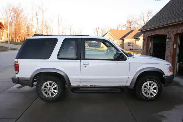

Changed the instrument lights to LEDs :) There were two burnt out so I said what the heck, LEDs will be cool.
BEFORE
AFTER
Also I decided to paint some things while I wait for tools, supplies and time to do my suspension upgrades.
Before
Primer
After
More pics and info sometime this week.
As far as body lifts, i still have mine sitting in closet from my 99 ranger. Never got a chance to put on it. I know it fits the explorer.
Yeah, I will probably do my leaf springs and TT stuff first, I think I'll enjoy the firmer ride in the back. The body lift will just be a visual improvement.
Looks better without the valance.
Also painted the trim and removed roof rack.
Painted by the windows, the wiper arm, bumper cover, and the handle
Painted by these windows too.
Painted wiper cowl and wiper arms.
Looking good. I do think you will like the firmer ride of the leaf packs and tt. I like how mine rides compared to my parents stock explorer. I need to paint my pillars near the windows they are faded now too. Personally I think explorers look naked without a roof rack.
Yeah my roof rack was incomplete so it looked like I just had a spoiler on it. I think at some point I'll put a cage style rack up there.
