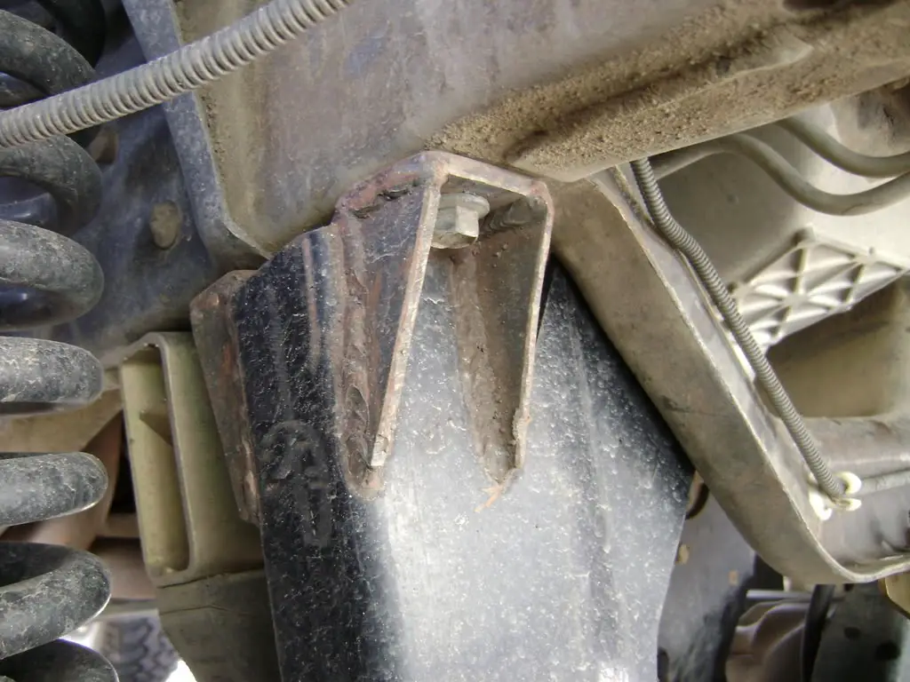

After a few months of wheeling my 1994 Explorer with the SuperLift 4" suspension lift I broke the front lift bracket. It has two tabs that mount to the passenger side frame rail and another tab under the engine cross member. The tabs(front and back) broke on my Explorer. I have the same lift on a 1984 Ranger and never had any issues with it. I pulled the bracket and made some gussets and fixed it. WELL, now I have broke the same bracket on my Ranger. I decided that it would be a good time to snap some pics and do a write-up on the fix. Here it is........
This is what I mean when I say I broke the tabs off of the lift bracket.......

Fixing the SuperLift axle lift bracket(PN55-01-1170/IFS Ranger,BII 1983to1997 and Explorer1991 to 1994.
