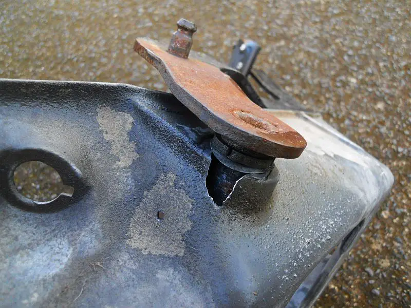

When you have the pedal assembly out to put in the new bushings, look for wear or breakage where the clutch pedal mounts and pivots. It's a weak point in the bracket.
I think you're right about the pedal slop helping the bushing to fail. I'll go further - I think in my case, driving with a bad slave for an extended period caused the bracket to break away, which caused the bushing to fail.
With a bad slave that wouldn't release the clutch completely, I would press the clutch in with all my might to try to get that little bit further pedal travel. That caused stress cracks and then pedal slop.
I just recently replaced the bracket. Here's the broken spot on it.

I strongly suggest you look closely at the area in the pic I posted. It's kinda hard to see, unless you get your head up in there and have a good flashlight, then wiggle the pedal as you watch where the play is.

- Couldn't detect damage to the aluminum bracket. No visible cracks. I will check for protrusions and bulging at the top now that I have looked at RangerX's pic some more.
