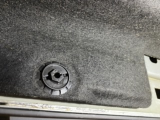

In my 2020 Explorer ST, I kept hearing a strange fluttering sound that appeared to be wind related. I finally traced it to the passenger side from somewhere down low.
I crawled under and noticed the felt covered cardboard looking undercarriage trim was loose and easy to flap around with my hand.
I zip tied it. Problem solved! Was driving me crazy for months.
I haven't looked at my explorer but, I wonder, is a nut missing from the stud beside the zips?
It's not held in by a nut. Mine is the same way. kind of cheap if you ask me.
In the upper right corner of the photo, you can see the nearest flat nut. It was loose. I tightened but the trim was still wobbly. There are a couple of other push pins and nuts on the trim. I agree with what "themishmosh" said. Poor design.

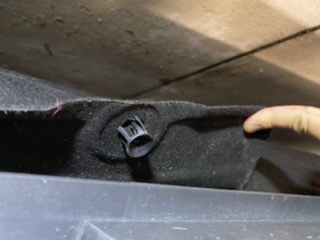

This retaining clip on the side bottom, just behind the drivers door was loose as can be. the same one on the passenger side was tight. I took it out and bent some of the plastic grabbers inward but it doesn't look durable at all. at least now it holds the under carriage in place now without the flapping/tapping noise.

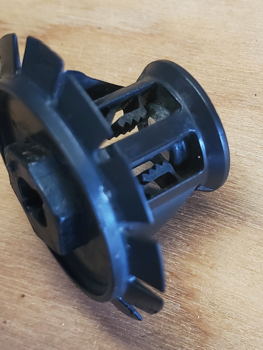

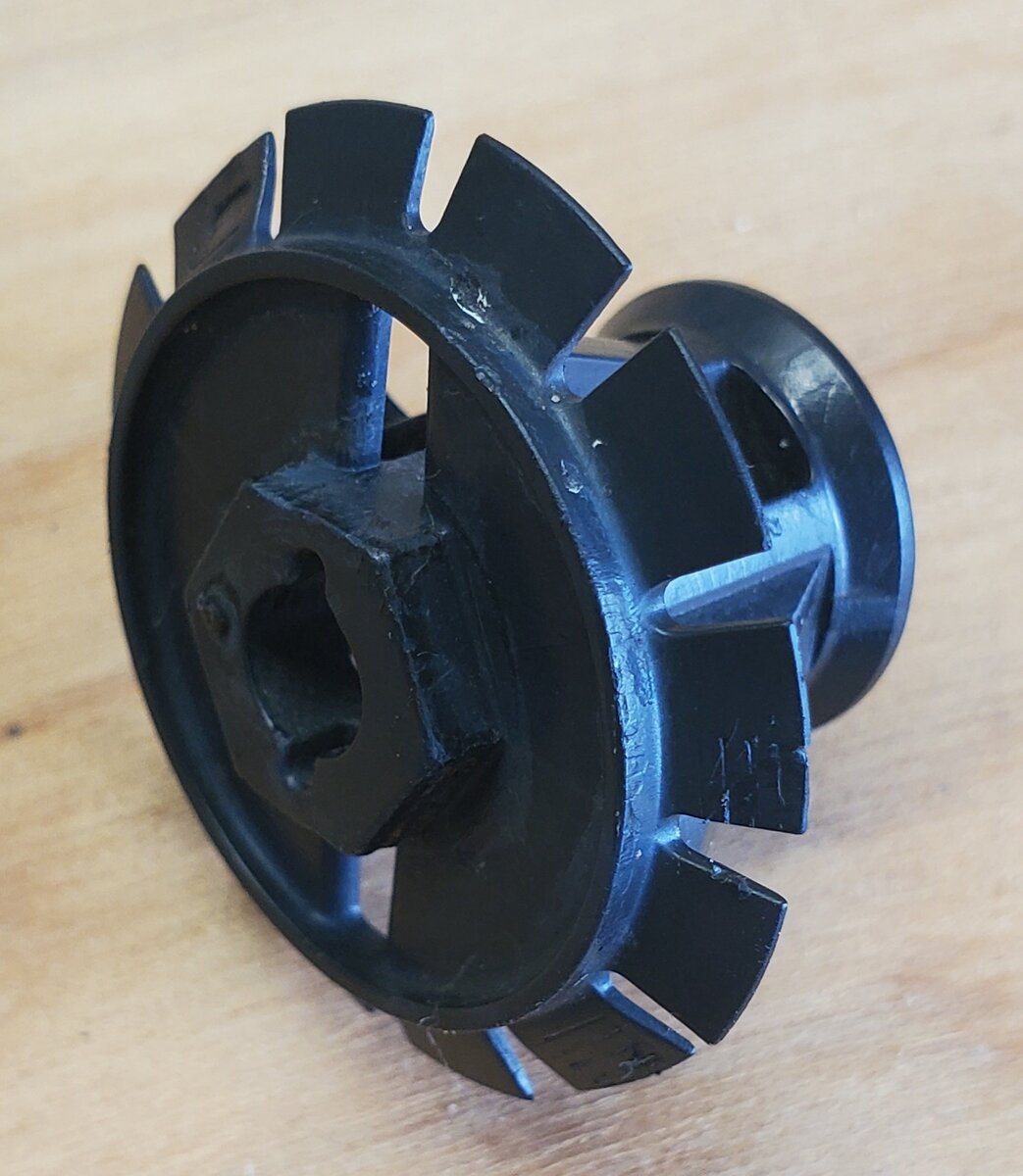

Well, its raining cats and dogs so I can't get a pic right now of the final result but here's what MY failed plastic retainers looked like - pretty detailed item - but no one at Ford has seen these. They get replaced with a much simpler plastic retaining device (no pic - sorry).
Yeah thats the item. I'm in the salt belt though so I don't want to replace mine with standard off the shelf nuts and washers. They'll be destroyed by rust in a season. Back to the drawing board.
