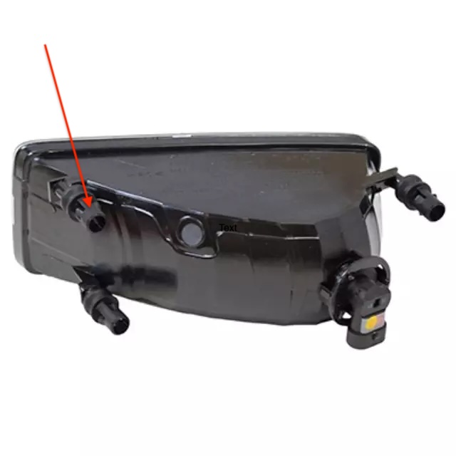

I recently replaced both assemblies on my 2009 XLT because they were both missing the lens. Inside of the plastic mounting tubes (for lack of a better description) were Phillips head screws. I didn't attempt with mine but there may be an adjustment there.
