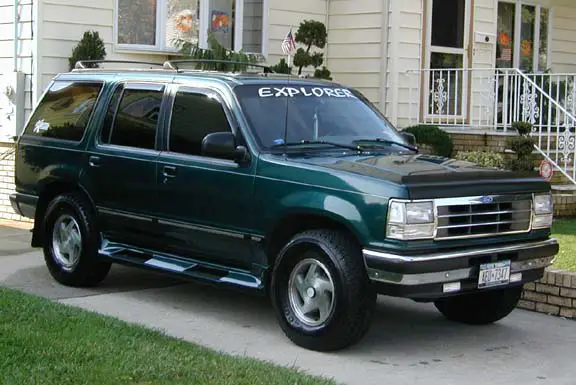

I like where mine are...
Yea ChuckyD, that is exactly what I want!! What size and what brand of lights did you get? Did you saw out that little plastic piece in between those openings? Any help you could give would be great.
Its an off brand with PIAA superwhites. I think they are like 2 x 4 or like 2 x 5. I just got any light that would fit comfortably in the space that i had. Just center them as best as you can and cut. the lights i have were mountable on flat surfaces, so looking for that is a plus.
