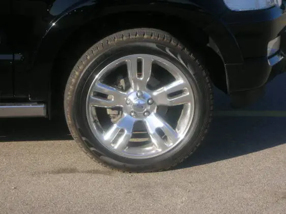

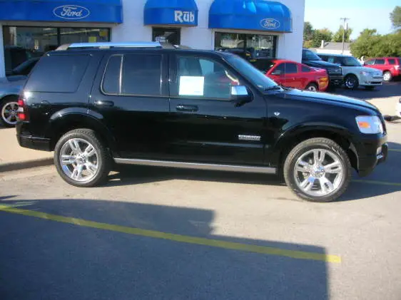

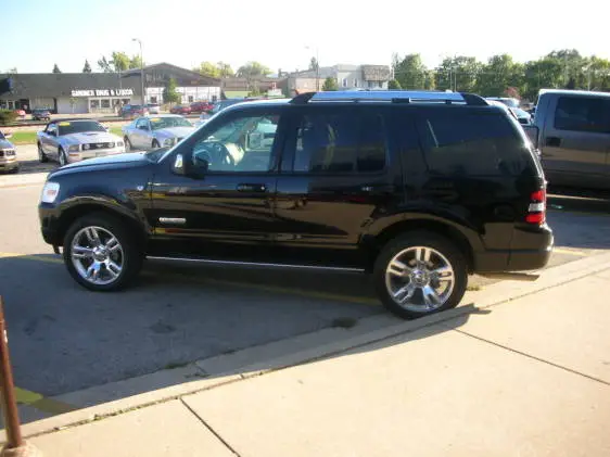

i put 22's on my 08 explorer bolt pattern 5x4.5 and tire size 265/35/r22
