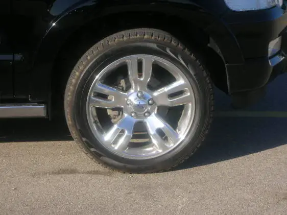

Those are the 20" Sport Trac Adrenaline wheels BTW... and they do look badass! But be prepared to pay a lot for them, around $500 EACH from price I was quoted.Around $400 each for the Edge 20"s, then they are CRAPPY made fake chrome at that... aluminum rim with a plastic cladding (glued on hubcap):thumbdwn: Better off to go aftermarket.:rolleyes:

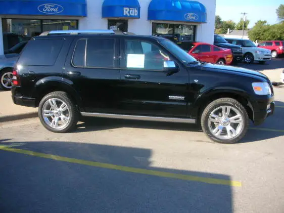

Why not try and find a set of 20" rims that Ford put on the late model '08 Explorers? I think they look pretty bad a$$! :thumbsup: BLING BLING! :D

No, the offset is different. The IV genreration rims have an ET of 44 mm. The 99 generation II have an ET of 12 mm.
If you install these, they will go more to the inside of the car.
Hub centric spacers and longer lugs would fix that.
