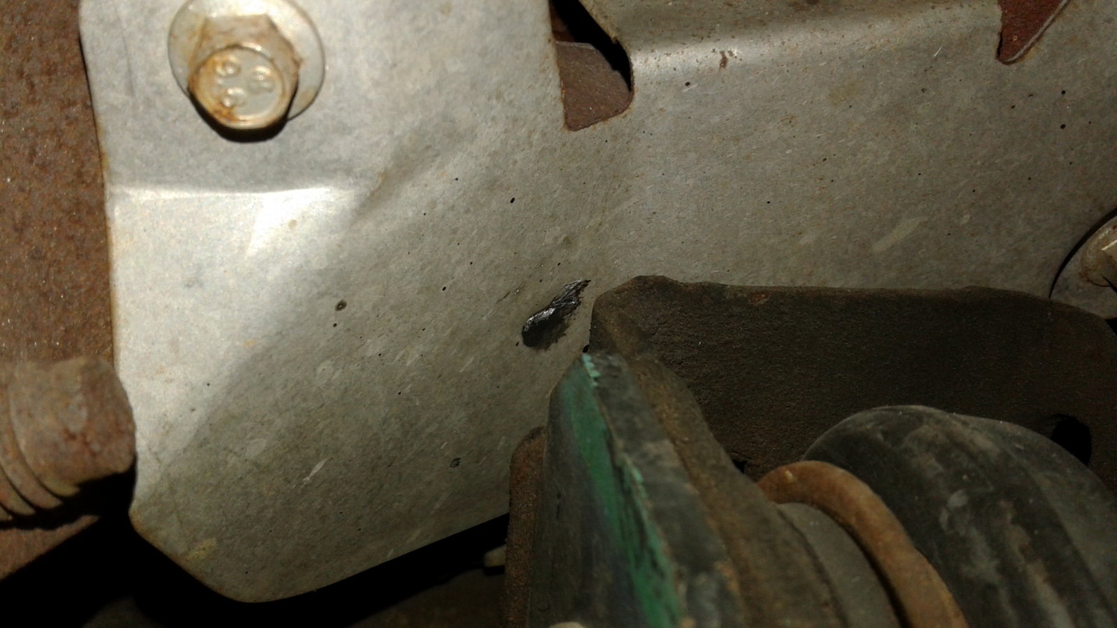

This is an accident related question. I'm trying to determine if our 98 Mountaineer 5.0 is fixable or not. Would it be possible for someone to take a look at their 5.0 Explorer or Mountaineer to see what the clearance is and possibly post a picture of the area between the frame and the passenger side exhaust manifold is?
It's not much, I've got to replace the manifold on mine and it looks sorta miserable.

I'm pretty sure the frame is bent. I can't find a shop that will say that they are able to do it. One has a 12 ton machine and says that a 20 ton machine is needed. The nearest one I can find is 200 miles away. Here is a couple pictures of the frame near the exhaust manifold.

At best the frame could be pushed into a diamond shape on the front end.
That would take a lot of force.
Is the left side just as close to the exhaust manifold?
I know its tight in there.
How do the body panels fit on the left side?
