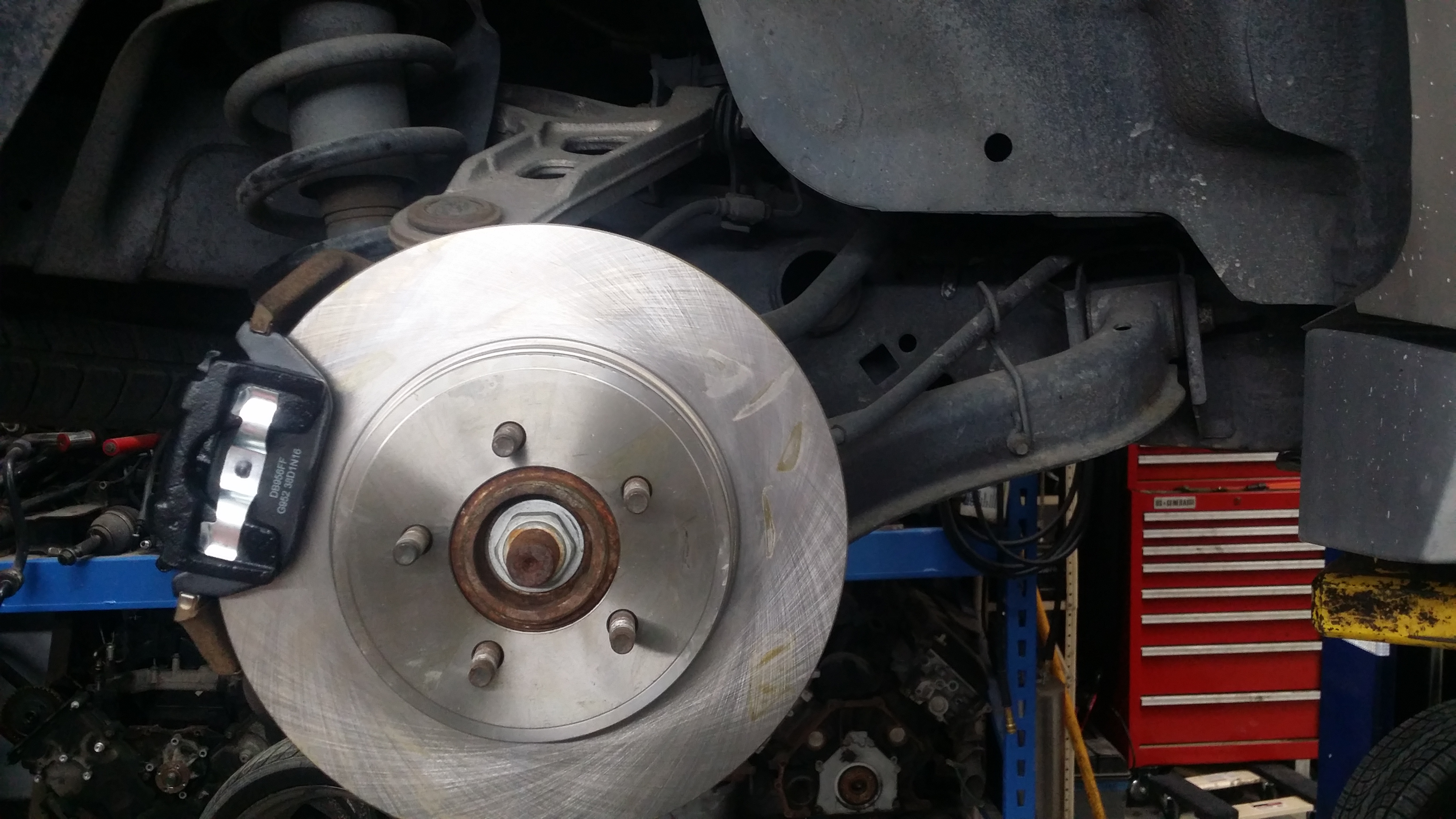

54k sure drives nice. So to start the project, to go fast, you need to be able to stop, and this thread gave some great information. Well straight to the point.
The Aviator knuckle is half the weight of the Sport Trac iron one but when you add 60 lbs of rotor, caliper, and pads, I came out at net 0 same 70 lbs.

Yes that’s the rear 2010 st, it makes things much easier for mock up the diff,billet rear latral links and radius arms. The diff is a 2018 GT350R with track pack oil cooler and 3.73 Torsen. The rear cover fit in the stock location just about an inch and a half to low so the bushings need to move up or just machine a new rear cover it’s a 8.8 nodular iron case 130ish lbs nothing the same as the stock aluminum case pluse the stock case is good for only 500ish and 450 toque I’d like to all most double that. I’ll use the jig for set up on the pinon angle,half shaft bar length,e brake cables. Than with all the mock up done in to into the Red headed girl friend, as my wife calls her. With the least amount of down time. Just a tease any one look in the back ground? More picks of the rear up right and some front brake pic
Some front brake pics. The answer to the question 06bluez 2015 -19 GT350R, The fronts are 15.5” with 6 piston brembos rears are 15” 4 pistons and of corse massive pads, I have a 2014 E350 van with 2015 F350 axle in it and the mustang pads are bigger than the truck pads. The first pic is my 2010 stock rotors and the mustang one.

the rear brakes on the 4th gen lend them selves well to the brembo mustang swap better then the mustang :) the mustang gt brakes use crap calipers with built in ebrake and they have to upgrade the knuckle to the gt350 hat style to use them. I will have to look if I have the rear brakes, I do have all the 15.5 bling gt350r parts for the front and a set of the 'upgrade' 15" brembo calipers here, I just dont recall if I bought the rear stuff. I will have to go digging and acquire some aviator stuff to have a comparison day. 13" rotors would be a great upgrade, i dont think it would be too much work to go with the 15" brembo mustang upgrade stuff in the front, an affordable available rear rotor for upgrade might be the difficult one.
