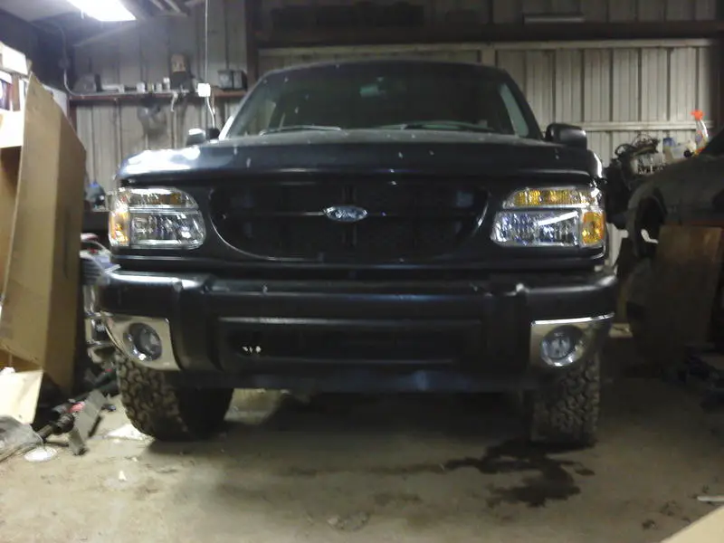

Sorry I forgot to post pics when I finally figured it out. They are crappy and the truck was dirty but I think you can see that its holding up very well.

delexploder, the pics looks good. Another reason why I wanna do the swap. How long did it take you to do the swap?
Its only four bolts and the two plugs for the foglights. Id say maybe half an hour to swap out and about the same to paint.

No the brackets for the lights stay on the bumper just undo the two bolts per side where the bumper meets the frame and the two plugs for the lights and that's it here are pics of my mounty I just swapped its bumper also

That looks good man, I like that alot. I like how it matches the molding on your doors as well. Very sharp man. But for some reason I guess I'll understand it more with the bolts that meet the frame once I do the bumper swap eventually after I get this damn motor swapped. But yeah def like the look of that bumper.
