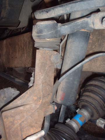

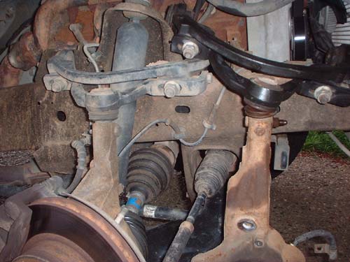

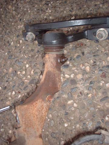

Clark.. the trailmaster kit utilizes the stock spindles, correct? That means that this kit should work on your 2WD if you put your stockers back on. I'll go out side and get some pics to make sure the spindles are the same (at least the top part where the trailmaster extension hooks too).

Here is the 4WD on the right, 2WD on the left:
2WD side:
4WD side:
In my professional *cough* opinion.. I think they're the exact same.
I'd maybe get Ray Lobato over here. He's the Trailmaster Master... master. :D
