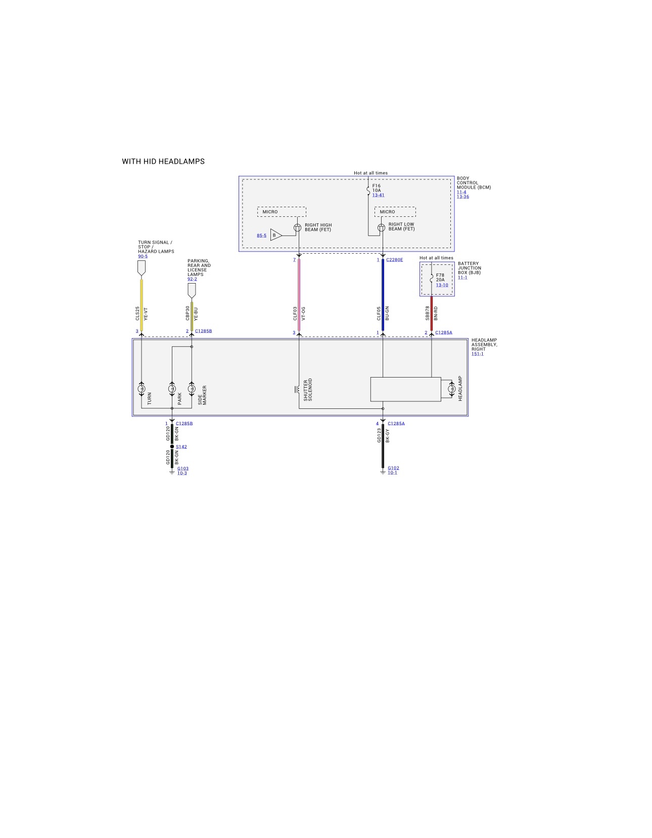

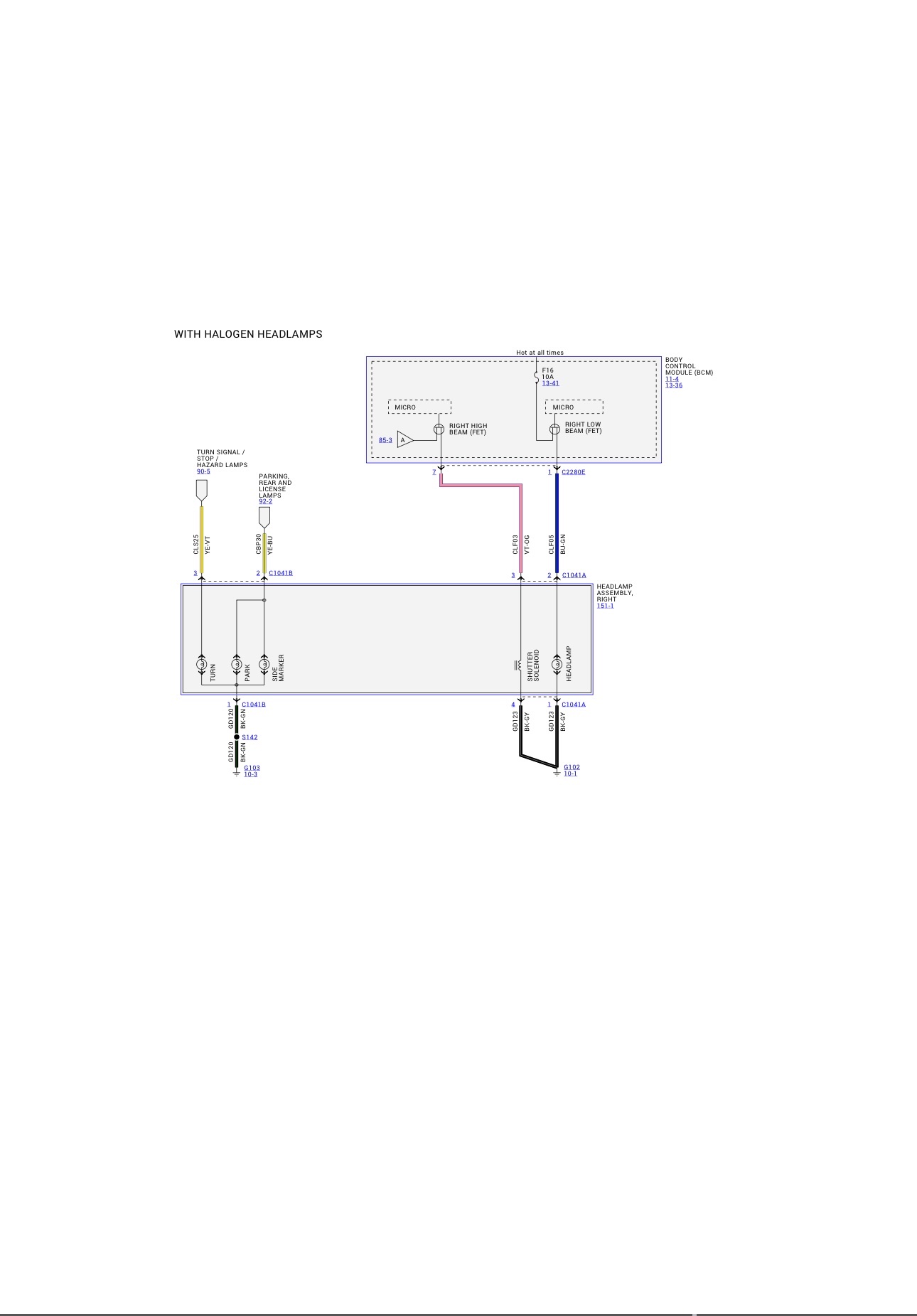

Can anyone share a wiring diagram for the headlights/turn signals/side markers for a 2013 PIU please? Whoever decommissioned mine mangled the harness on the passenger side.
These? Halogen or HID version for the PIU
That might do it. I will look when I get over to the garage after lunch. If I am still having an issue I will post a couple pics of the rats nest in there. Thank you!
