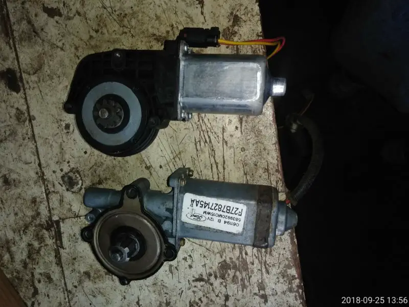

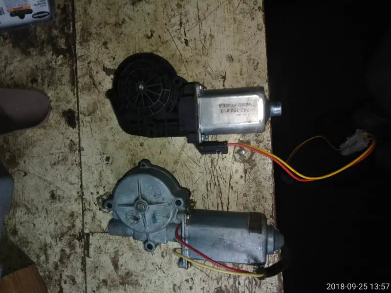

Okay so I dug around in my spare parts pile and found a driver side front window motor out of my 1991 parts Explorer. I know the top where it mounts is different but if the motor with the shaft is bad in the window motor from the 1994 Explorer is bad can I swap the shaft with the motor from the 1991 window motor into the 1994 Explorer window motor?
are you talking about swapping gear drive heads ? I kind of remember doing Exploratory Surgery on an old Ford window motor once and it kind of fell apart and I was unable to get it back together. Not sure myself...
I mean using the original top piece with the mounting holes from the 1994 Explorer. I meant if the shaft with the motor is bad can I swap the shaft with the motor on it from the 1991 into the 1994. Or worst case if I have to the bottom assembly and the shaft with the motor on it.
The bottom assy I see has the F2 (1992) part number on the sticker. What year is the top motor with the plastic head on it out of ?
It came out of a 1991 Explorer. I know the plastic head won't bolt into the 1994 Explorer. The label is a little blurry but I got 742250810 16060KOREA from it.
