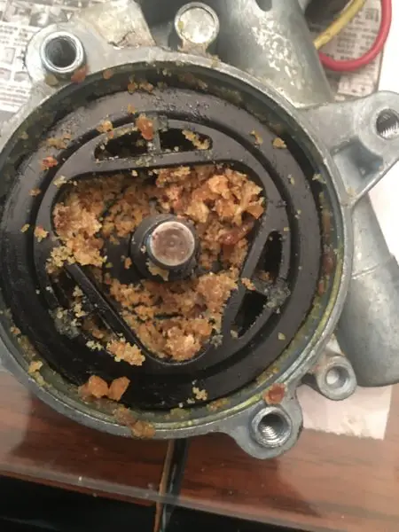

AZ3008 I have a 95 Explorer , The window just started chattering when its just about 3 inches to to be fully opened ans also when you hit the top it will chatter. It still opens and closes between those point fine . Im thinking its probably the plastics in the motor shot . But if I read your post did you say it could just be loose bolts on the motor ?
Tightening the motor bolts is the easiest solution and you should try that. Could be the regulator i have no clues when it comes to power windows lol. On my 91 the plastic gear plugs inside the motor had completely exploded haha. Everything worked fine after i replaced the gear plugs.
