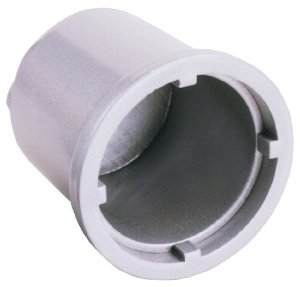

Are you switching from auto hubs to the Warn hubs? You'll need the locking washer set that goes with them, I think what you're calling axle nuts. They are different from the ones for auto hubs. Also different is the socket to fit them, you'll want this type.
