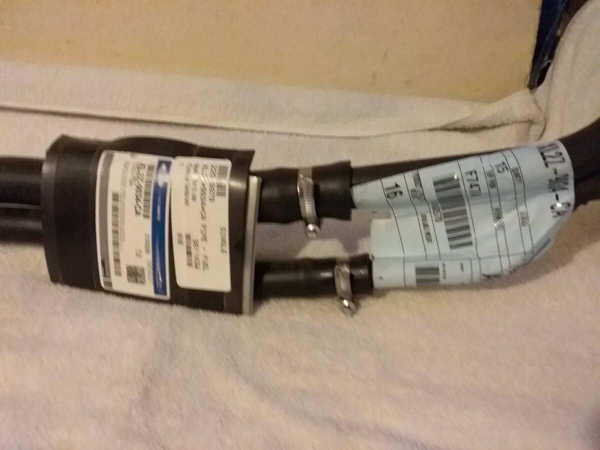

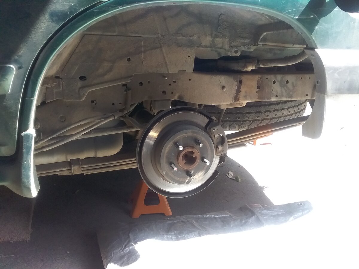

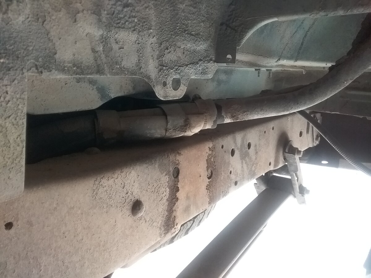

When filling up my gas tank, I noticed the fuel filler started to leak right at the connection with the metal neck. I spotted it when I replaced the fuel pump recently. I ordered a replacement from Tasca Ford and it arrived yesterday. I'll install it and hopefully post a few pics along the way.
While sourcing the replacement part, I noticed a huge discrepancy in pricing, starting as low as $37, and as high as $350. Looking a little deeper I discovered that this part was sold in two different combinations: Just the neck (no hoses) and complete unit (neck and hoses). Unfortunately, I found it difficult to determine which was which with some of the parts listings. Although the replacement part number was consistant, as well as the image included, Tasca Ford was the only listing that the hoses were included. I was relieved when the part I received from Tasca Ford was in fact exactly what I needed.

Just finished up installing the new Filler pipe, with no problems at all. This was the dirtiest job I ever did on my Explorer

Can you post the part number?

I ordered the part through:
getoemparts.com
401-709-7836
PART #: XL2Z-9034-CA
DESCRIPTION: Filler Pipe
PRICE: $201.74

I believe that all three engines for 2000 Ford Explorers (4L V6 SOHC, 4L V6 OHV, and 5L V8) all use this same part number. The exception is the Sport Model.
