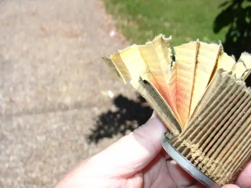

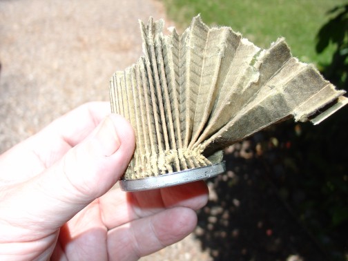

I decided to change the fuel filter on my '99 SOHC today. Its been 70k miles since the last swap.
The truck has been running good and the mileage is excellent, therefore, I didn't expect the innards of the filter to look too nasty.
I cut open the filter and removed the pleated filtering medium. As can be seen from the pictures, the material is discolored brownish, but not very bad.
The pictures show the outside of the media as well as the inside.
The filter swap was a 5 minute job with only a slight hassle with the removal tool [ I hate ford fuel line fittings ].

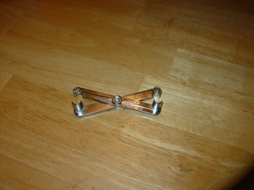

Al, you mention using a "removal tool". Can you let me know that is, or an example online?
Thanks!
Thanks!
I purchased the tool, pictured below, at Advanced Auto Parts a long time ago, therefore, I do not remember the maker or the cost.
You should be able to get such a tool at any auto parts store for less than $10.00.
It has tow sizes, 3/8" and 5/16"; use the 5/16" sizr for the Explorer fuel line.
This tools makes removing the fuel filter a relatively easy task.

Is that the K-D tool? What octane gas do you use? Do you buy gas in a certain gas station, or just wherever it's more convenient? It's hard to believe how clean that filter looks with kind of mileage.

advance auto now sells that same fuel line tool marketed by AmPro, roughly 10$s or so.....
