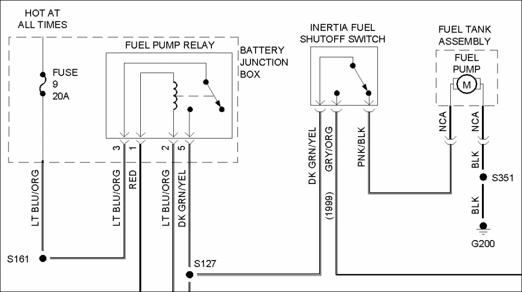

Ultimately, when it won't start, I'd check that 2nd gen wiring diagram for the path of the circuit and use a multimeter to trace the circuit and see where power stops, remembering that the fuel pump only runs for a moment each time the key is turned to run, if the engine isn't running. If it turns out that you get power all the way back to the fuel pump, also take note of whether the voltage drops too much when the pump tries to run, which could be a sign of frayed wiring or fouled connector(s), or of course if the fuse or relay box has fouled or weak contacts. Unfortunately many of those power checks can be a 2 person job if you just have a basic multimeter with short leads, so you need someone else to keep turning the key on and off.
Here is a portion of the fuel wiring diagram showing the most likely places to test, and the relay contact designations and wire colors:

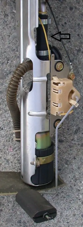

Did you also change the short rubber fuel line with new clamps?

If it drops rapidly then there is a internal leak, short rubber hose cracked or

I do not think the fuel pressure regulator ist bad, mostly the short rubbber hose is bad.
