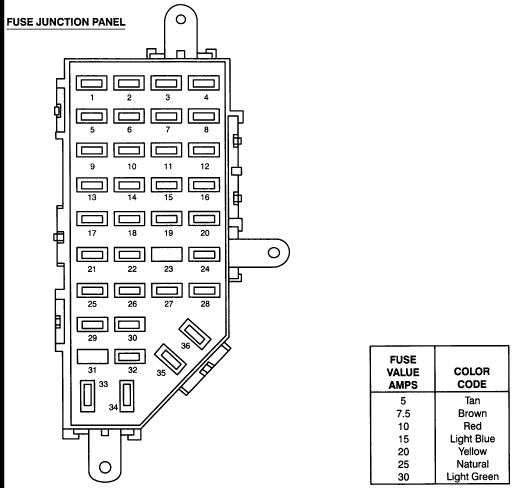

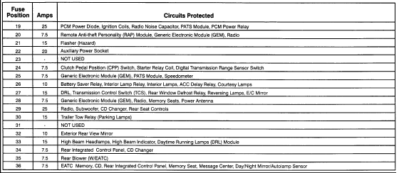

I changed the terminals and battery on my '96 Explorer Sport. While 'trying' to fiddle with the old terminals, I unhooked/hooked up the terminals quite a few times. Got everything taken care of. Started her up and my audio was shot. No juice to the amp or radio. I checked out the buss fuse and it was fine. I'm an audio idiot, so please bear with me. In the 2 1/2 years I've owned the truck, I never had an owners manual....(and it seems every time I'm at the parts store they never have any in). Anyway, after the rant (sorry I'm exhausted)....my question is...'Which fuse locations should I check?' (...And any other advice!).............Any help is appreciated. Thanks in advance.
