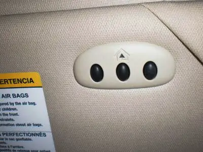

Driver's sun visor. Here is the one in MKT and is similar to the Explorer. It is Standard on the Limited and Optional on the Sport models.
First thing to figure out is if you have the Car2u system or Homelink. Homelink has a picture of the house with 1 light like Peters. I don't believe they started using Homelink until 2013.
If it is Car2u you may need a repeater because most garage door openers are not compatible with Car2u.
