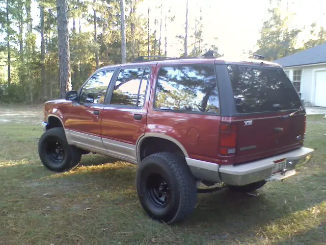

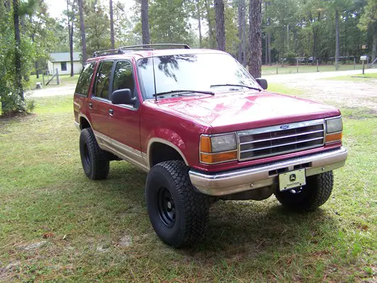

i have the RC 4 inch and 33 12.5 r15's i did not need the extended brake lines but they are to there max i will be replacing them. the abs wires are not long enough so go to your ford dealer and ask if they sell extenders and let me know cause i just unplugged them lol and they are still unplugged to this day.
