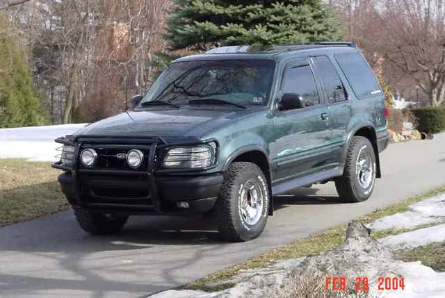

Ok,, So I am trying to keep it looking mostly stock. You can look at my pics at car domain, I have the 16" rims and 265,70,16, Wrangler RT/S tires on it and don't want to replace them, I put the car on flat ground and jacked it up exactly 2" and it was higher then i thought. They say shackles put it up 2" correct??? so is there any way just to put it up an inch , just to get rid of the sag in the back, that's all i really want! Thanks for any help!!! Check out the cardomain page and let me know what you think
Get a leaf pack from a 4 door. Our Sports have a mono(single) leaf in the rear which serves its purpose, but not very well. Either find one from a junk yard(91-01 will work) or buy new ones. I got mine off a '94 and they cured all the sagging! Good Luck!
Nice color BTW :p
