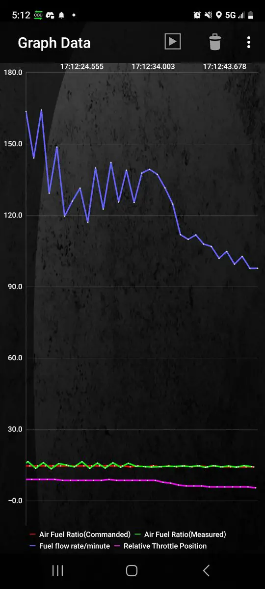

I graphed some of the engine data to help provide insight, hoping to find a sensor that didnt act congruently with all the other signals. I found exactly what I had expected. Fuel pressure on the fritz, AFR in tandem. I've watched the AFR spike to 29.38, over double the norm. So it seemed that the engine was being fuel starved. Ok, great, replace all fuel related components. Well, did that. No dice. The issue does seem better in certain aspects, but is still present.
