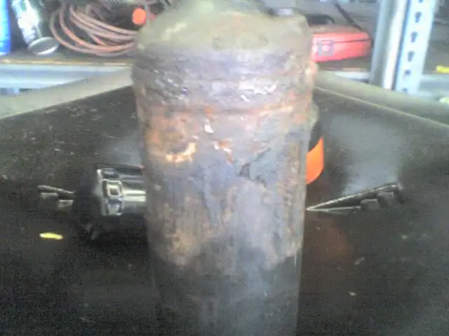

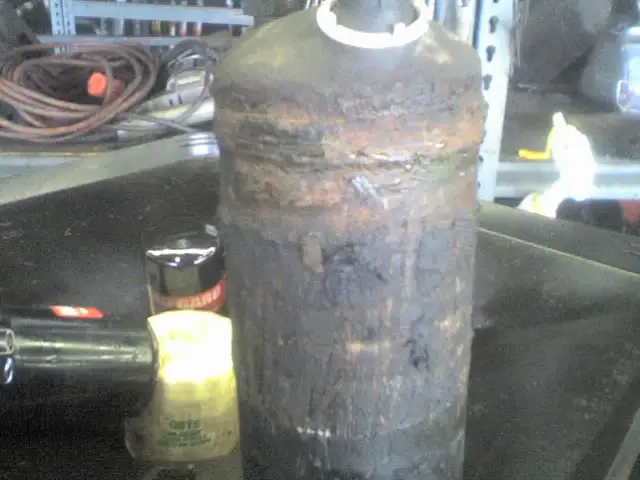

Well I just realized today my A/C wasn't blowing cold anymore... pissed because less than a month ago i got it fixed. Well, they placed dye in the system to check for leaks in case it went out again.. guess where?? My Accumulator was saturated in the dye.. i'm afraid it went ahead and blew up. I'm sorta happy cause it will finally be fixed and stay fixed. I'm sad cause that's at least another 100$ out of my pocket. I don't wanna do it myself because I don't have the right tools.. so i'm gonna see what happens and ill post back later.
I was a little skeptical of the dye clogging things... Anyway what do you guys think? I paid 39.99 for a complete A/C inspection in which they claimed to find no leaks (which i believed them or they would have told me i'm sure). Should I tell them they should have noticed my rotting accumulator? I don't mind paying to have a new one put on, but I don't feel I should have to pay to have it re-charged AGAIN. They should have told me it was going bad and offered to replace it in the first place. I am not an ####### and don't demand anything from anyone incase I feel i'm getting screwed, but what would you guys say are my RIGHTS in this case since I paid for the inspection?

ok well they replaced the Accumulator.. right around 100$.. i don't know what it "should" cost but i heard at least over 70 so i wasn't going to argue 20$.. they didn't charge labor or inspections.. check out the old accumulator..

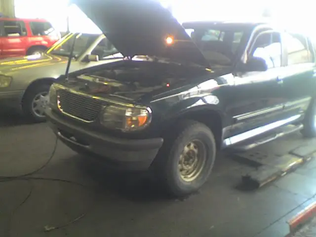

also check out my awesome spare tire i got on there until tomorrow.. i'm getting 4 new Uniroyal Cross Country tires..

The rusting accumulator is a common Explorer problem. In this case, it appears to me they flat out missed it, although it could be that it was not leaking at the time of the test, and if the foam was still on it, it might be an excusable miss. If it looked like your pics when they inspected, they should, IMHO, replace it, evac and recharge and only charge you for the materials and labor to replace the accumulator. (Which they would have done had they properly done it last time. My 2 cents.

Went in today and they saw there was NO pressure - nice guys, let me watch them inspect.. I saw the dye all over the accumulator - they couldn't find any anywhere else. They evac'd it.. still couldn't sniff out a leak so they tested it in the water and still wasn't leaking (it was obvious bythe dye it was the accumulator)..
He offered me to replace although he couldn't "Guarantee" the accumulator was the problem due to testing it multiple ways.
Replacement was 96$ plus tax and no labor charge or inspection charge. They were very cool guys and now my A/C works again.
