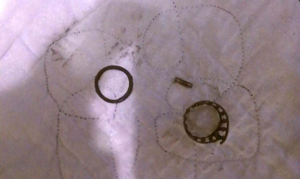

I'm using the 911 feature again today! My 93 has developed a grinding noise that only seems to be there in high rpm 1st gear and low rpm second then it disappears. I have taken apart the rear end checked all bearings put new fluid. Checked all the ujoints. Took the front end apart checked all the new parts all bearings and seals are good. Took the transfer case apart and checked all bearings everything looks good. Any ideas?
Well here is what's left of the pilot bearing! I think this may be the problem!
Hmmm, sounds like the pilot bearing...
Oh, you figured it out already.

Hope that's all it is. Strange it failed so quick though.
Did you have a look at the trans when you had it out? Fluid condition, or pull the bearing retainer off for a look?
