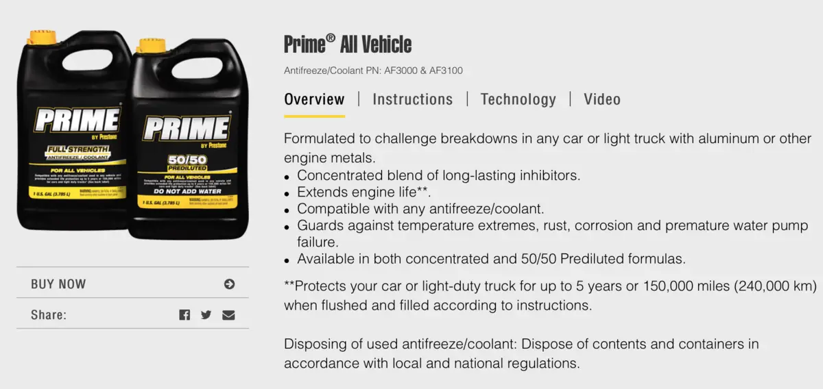

Regarding the antifreeze, is this stuff okay to use? I've always used the green Peak or Oreilly brand that says compatible with Ford, but I bought two gallons of this Prestone stuff and would prefer to just use it. I see they also make a "Conventional Green" and then an orange one (for Ford/GM). Thoughts?

Regarding the antifreeze, is this stuff okay to use? I've always used the Peak brand that says compatible with Ford, but I bought two quarts of this Prestone stuff and would prefer to just use it. I see they also make a "Conventional Green" and then an orange one (for Ford/GM). Thoughts?

For the least chance of problems with your 21 year old / 158,000 mile cooling system (and heater core, water pump, thermostat, head gaskets, "crimp" areas on old hoses), I suggest staying with the same exact PEAK/FORD formula that you've been using...
Sometimes changing brands/formulas that your system has "settled in with" will create a new set of problems.
Hope that helps, good luck & your mileage may vary :)
My thoughts exactly. Guess I'll be returning the Prestone stuff.
If at ant broke don't fix it ...use what was in there
