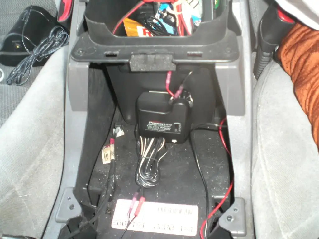

i have an xm radio and i hardwired it using a universal DC adapter. it was cheap and you can pick one up from walmart. you are able to select the output voltage so you can choose 4.5v or 6v, either will work. mine is set to 4.5v and i never had a problem. it was designed to plug into a cigarette lighter but i took that part off and hardwired it with a add-a-fuse into the fuse box. im not sure which number it was but the xm will turn on and off with the key.

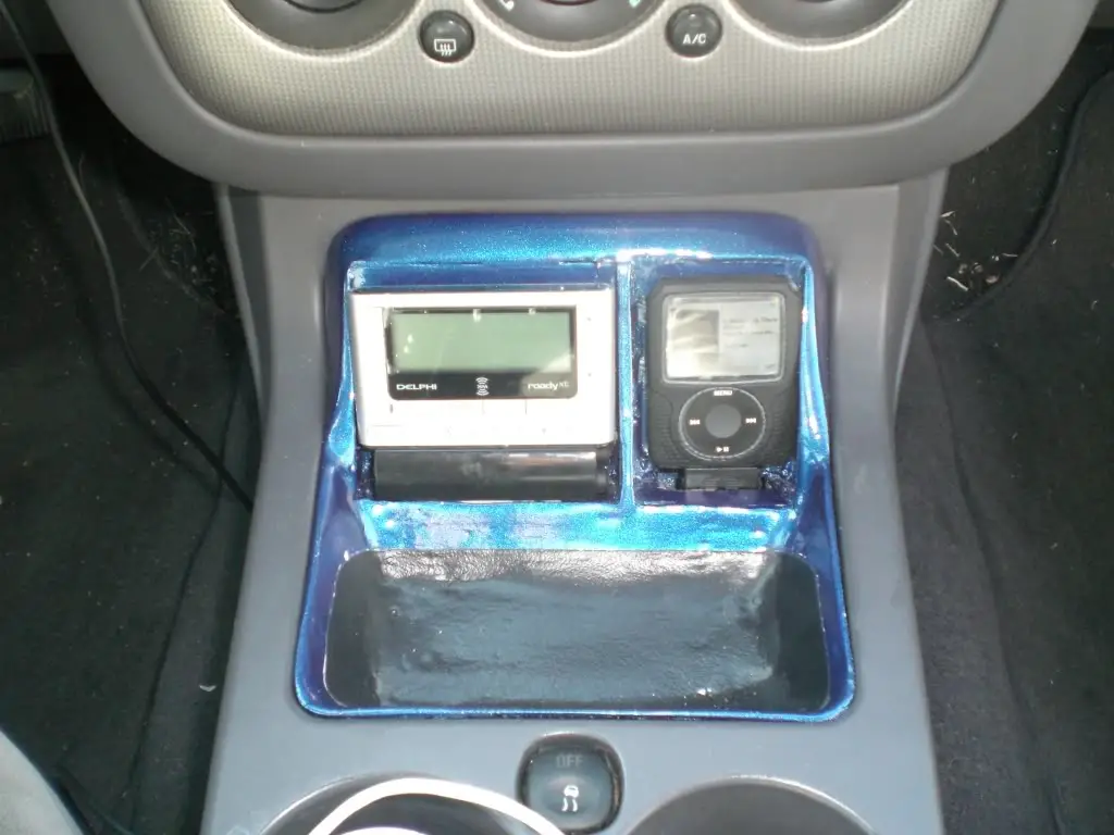

heres where i put the adapter: under the console against the box.
the two wires on top is where the cigarette light was. and the bottom wires connect the xm radio.
