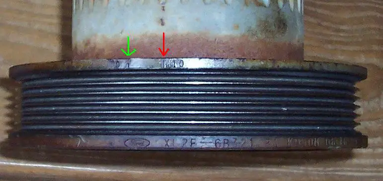

I'm not very familiar with the 2004 engine but if your crankshaft dampener/harmonic balancer looks like the one shown below then it needs to be replaced.
On the third generation models there seems to be a tendency for the outer section to separate from the inner section. See this thread for more details: Harmonic balancer failure
The second photo is of my 2000 SOHC dampener.
