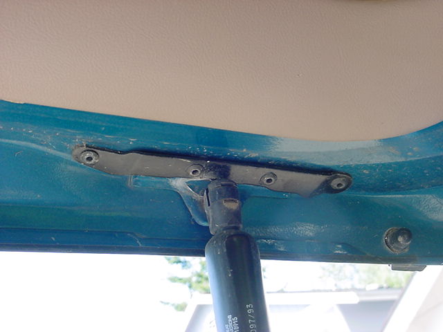

There is no weldiong involved. I actually had this done and all they do is take some thin steel strap about 5 inches long, covering the bracket on the lift gate itself. Then they drill 4 holes and pop rivet it in place to reinforce the exhhisting bracket.

I had the same recall done about 2 months ago, and the dealer only replaced the gas cylinders.
Later in the week......
I took another look at it today, and they did add the riveted reinforcement as well.

You should get it replaced bro. I ignored mine because I didn't have the time & one of mine broke off & messed my hatch up. It still doesn't sit right when it's closed. Somehow the lift cylinder jammed up in the area where it closes when it broke. I welded mine back on then they did just as stated above, pop riveted a bracket on each side.
Mine was done last year, and it was done exactly the same as Diff Whack Daddy's.
