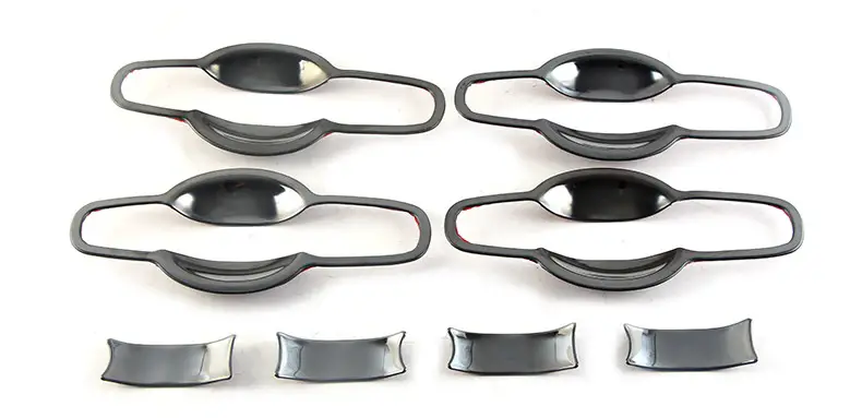

Well packaged. Each piece in it's own pocket of thick plastic and the 4 middle pieces in one place. Comes in a cardboard box.
Feel & Initial Impressions:
They are made of metal, although it's very thin metal and they would bend easily if you weren't careful. They weren't completely "clean" when they arrived, some of the white protective film was still on the edges, so they will need a quick "clean up" before you put them on. One of mine had a slightly different shade of color, rather bronze/blue-ish than black. But I decided to not let it bother me as they anyway change color depending on weather and reflection (see pictures).
Fit:
Mostly quite well actually. The part that goes around the handle (I'll call it the handle wrapper going forward) is pretty spot on size-wise. The plate that goes in the middle is too short by about 1cm (0.4 inches) on each side. It's actually not that much of a bother unless you look closely but I feel like this could've been done better. In fact, I wish they had just been one big piece and you were forced to take the handle off to install them. Would've been easier and look better. But it's fine as it is. That piece is the part you don't see until you're up at the door.

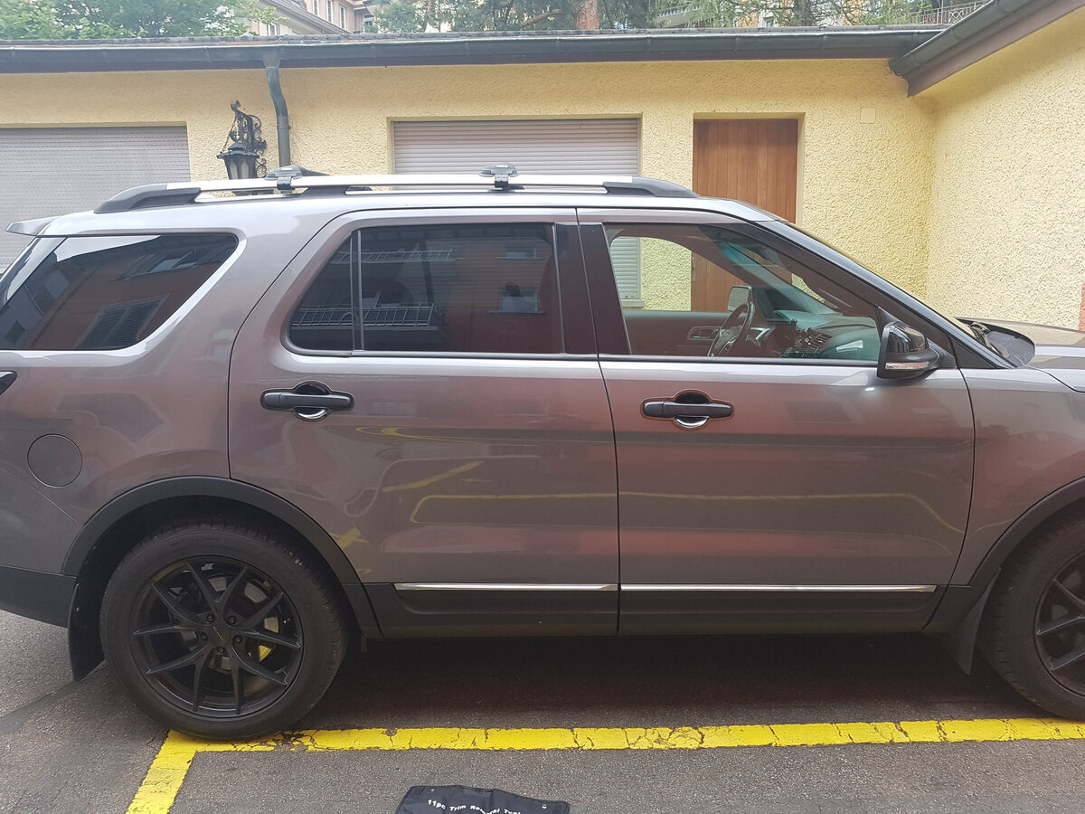

Pictures:
Sorry I didn't take closeup, let me know if you want one.
(I installed black door handles along with them, as I never liked the chrome ones).
