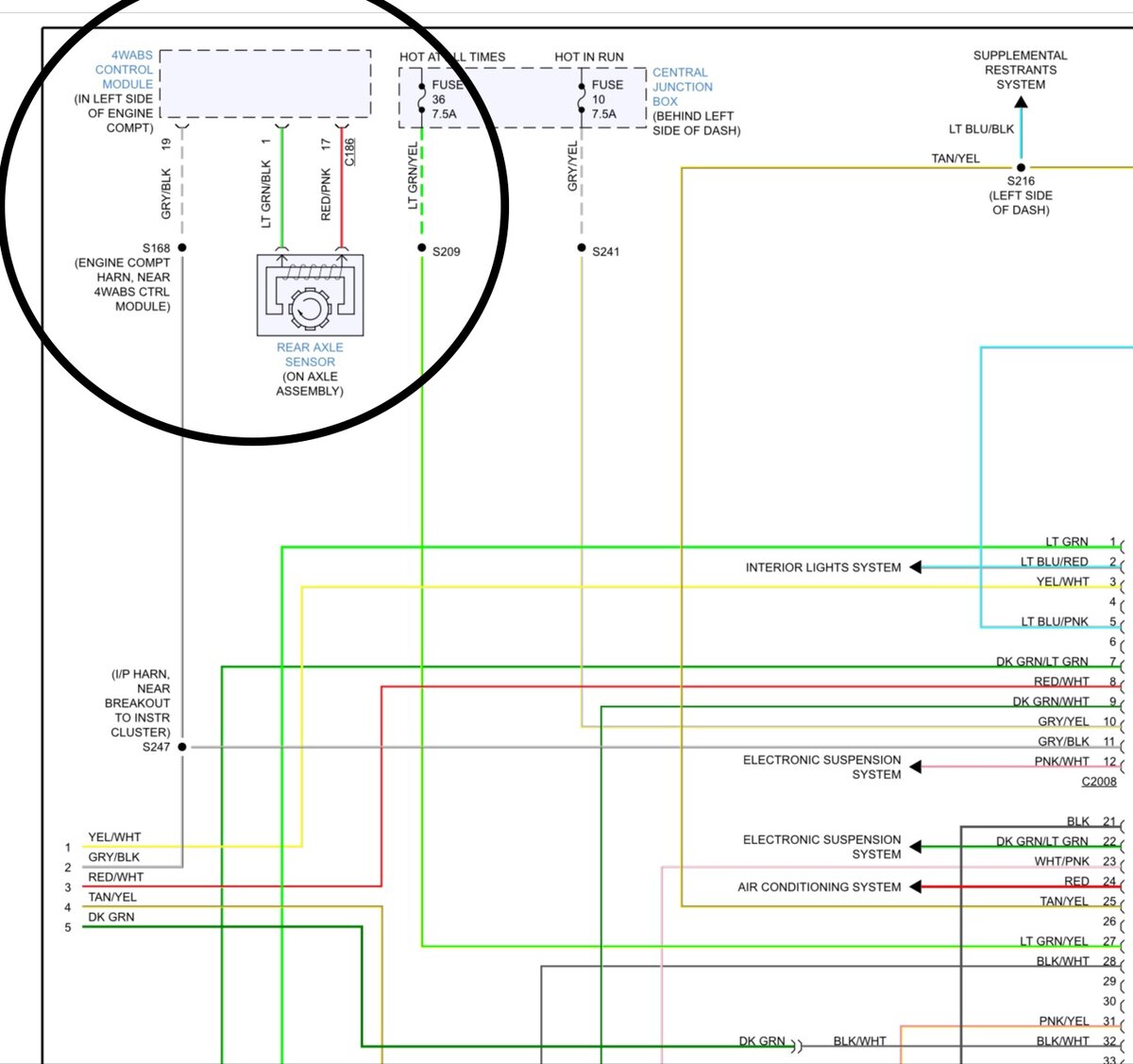

I'm trying to hook up the #68 - 679 (GY/BK) Vehicle Speed Sensor (VSS) +.
But what is the othe wiring I would be looking for? I look it up and I cant find it.
Its on a 2001 ford explorer 4.0l 4x4 Auto transmission.
I believe the grey/black wire is a signal wire. The sensor uses red/pink and light green/black. Hope this helps.
Brad
correct, the signal and ground wires are both found at the ABS module under the hood just like @transman304 showed you!

Yes its the same one. its a 2003 ford ranger 4x4 manual transmission. But the wiring harness am using is out a 2001 fod explorer 4x4 automatic motor wiring harness. i remove the auto part and wiring the wiring harness manual transmission PCM. i have everything map out just the VSS.
