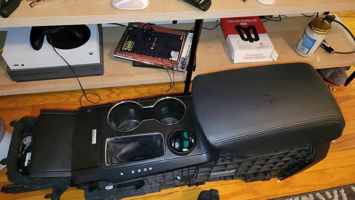

I'll do a write up on this later, but here it is, minus the 3D printed stuff I'll put into the holes later, ready to be installed.

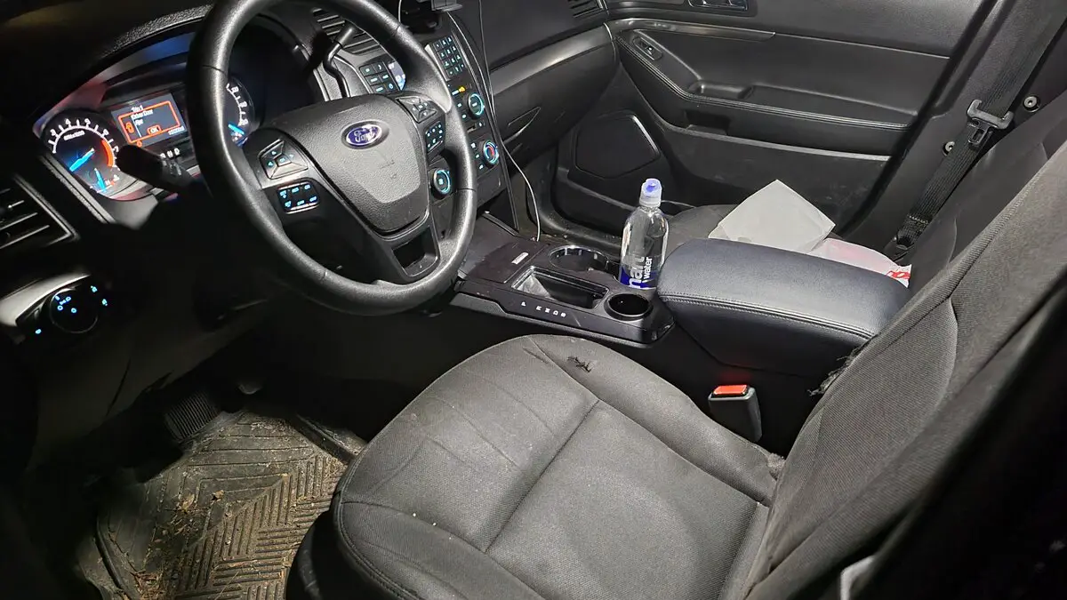

Maybe because the two plastic pieces that the FPIU uses don't work with the standard console?
I guess the difficulty is entirely dependent on if you decided to wire it all up with ambient lighting, sync controls and the 120v AC adapter.
Whelp, don't have sync, so didn't bother with that. I wired one of the 12v plugs and I got the model without the ambient lighting. I plan to make a harness so I can wire up the rest of the power points and the USB plug just to provide power for charging my phone.

Yes. I did mine without removing the seats. You'll have to move them all the way forward and backwards throughout the install, but it's possible. It's not easy, but it's possible.
can you do the swap without removing the seats? I bought one from a wrecker but haven’t installed it yet.
You can do the swap without removing any seats. For removing from the donor car pop off the two side panels, they are held on with clips only. This will reveal 8 10mm bolts. on each side there are 3 going into the console and 1 going into the dash. They are easy to spot and not too hard to access using a short socket and ratchet. There are also some plugs and 2 Christmas tree clips to remove. Be sure to pull the two mounting brackets from the donor car as well that are bolted into the floor under the console. If you already bought the console and did not get the brackets you can get away without them since you will be bolting it into the lower dash as well as the rear bracket which is welded onto the seat support bar on every PUI already. It will just wiggle less if you can get the other two brackets.
