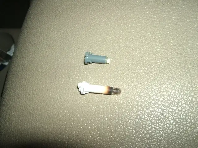

I will. I didn't even realize there was a light there! Thanks for bringing it up. I'll order it and try and make it happen. Can't promise pix, but I'll give a good description if I end up stuffing the socket with tinfoil or something! (Kidding). I guess I'll go with white to keep with the original color. I assume there is a green tint to the switch face.
Yes there is a green tint to the switch faces lettering so white would be best. I notice on the auto illuminations site they have standard bulbs too but the are the same measurements as the led. I am curious to the point of possibly ordering one of each for testing and or modification. my bulb was working but only if I hit the gauge and well today after taking it out and putting it back in it blew...guess I should learn to leave well enough alone!!!
SCORE!!!!! It worked!!:party: I was a little concerned because it was the "Super Bright" bulb, but it's a little shorter than the stock bulb, so I think that makes up for it. Also, you need a screwdriver to install it, no big deal though. Great find polizi212!!!!:dpchug:

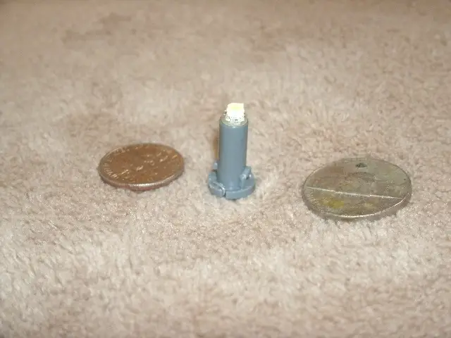

Hi, I found another solution for me.
(Ruler shows centimeters!)
I am glad to hear this glad I found that now I need to order one myself. How much brighter is this than say the other dash illumination? How long did it take for you to get the bulb ounce you ordered???
Holy cow Lukas! I thought I was a cool Do it yourselfer, and then you come along! I thought of doing that too....yeah...only I was going to melt down sand and hand blow the bulb. But I wanted to try this LED for the sake of the forum....yeah, that's it........LOL
As far a the brightness, it is the same as the entire panel, no difference. Oh and also, they do dim with the rest of the panel as well. Took like maybe 2-3 days from when I ordered it. Easy money....
