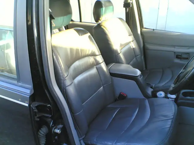

how did you get the wires to go through the seats? I tried to push the wires through and reached from bottom and felt that it was closed off midway to where I could go no further.
I undid the bottom of the seat back... it clips together, I put my hand up inside the seat and helped fish it though, then, I clipped it back together and job done
Si
Can you tell me or do you have pics showing how you unhooked the bottom of the seat? In the headrest holes, there's foam in there stopping me as well. Any tips? Thanks
I made a hole in the middle of the top of the seat... if you fold the seat forward, you can see the black plastic clip/strip
