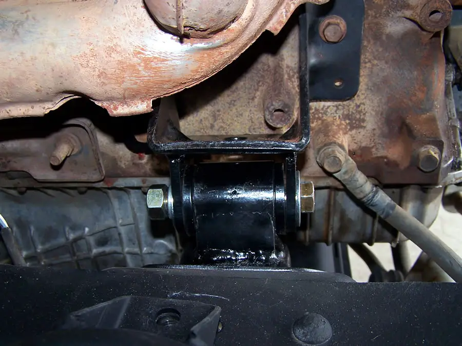

Here is what I did for my 2.3...
I will say that I know have to find all the little things that need to be tightened down or kept from rubbing. The bushings are very stiff, but I also know the motor will never contact the crossmember ever again, unlike the originals. And the motor will always be somewhat contained not just flopping around if the bushings ever fail.
