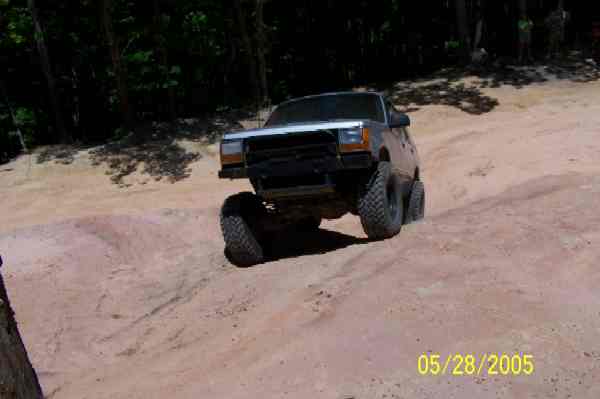

You are probably trying to get this:
To do that, you need longer shocks, longer brake lines, and flexier springs. The pictures above are with stock-length radius arms with rubber bushings, clearanced here and there for travel. It would have been better with longer arms for sure, and I also could have used steering fixes that eliminated the tow-in at max droop, but I never really noticed that much on the trail and it worked all over the country every place I wheeled.
