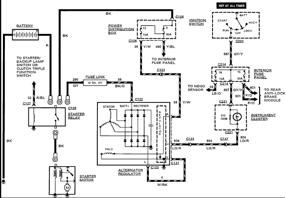

thanks turdle, thank god I have a nice boss. talked to him tonight and told me not to worry and to take the day off tomorrow and try to get the issue figured out. ill be working on this first thing in the morning. this diagram will help out big time. thinking outloud with the fusible links, I do have an extra alternator wiring harness but I believe it must be from a 93-94 as that mine has round plugs and this one has a bit of a different plug. can it be refitted with the plug connector of my 92 ( as in plug I meant he connection between wiring harness from alternator to distribution box...the one on top of the plastic fender well) they looked similar but don't want to jump in and it fry something else.

Hmmm, that fuse able link is troublesome. I have never found mine, and suspected it was in the fuse terminal on the fender, it's a 15A fuse. IIRC the fuse is the inside rear corner of the box, labeled "Alt Field".

whelp, froze my ass off for about 5 mins in the 12in+ deep snow and negative wind chills here in Michigan and can happily say it was the fastest fix I've ever done. it was indeed the 15amp fuse. stole the one for the hood light and she's working perfect now. thanks again for the troubleshooting help guys. never thought there would be such a small fuse for something like an alternator. I now have a new dilemma unfortunately...shes been sitting the past few days and windchills have been doen as low as -35 at night and now the transmission wont go into gear...had this problem last year around this time but it ended up fixing its self. one thing after another.... any ideas on that too possibly. shes starting to nickel and dime me....
