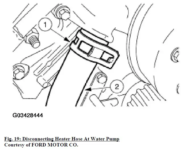

follow the heater hoses
I suggest that you follow the supply and return heater hoses. Start at the firewall and follow them forward. One should go to the vacuum actuated heater water control valve.
Also, follow the heater hose from the water pump outlet (1 in photo) to the firewall.
By the way, there's a possibility a defective heater water control valve can leak coolant into the vacuum hose that's attached to it.
It's always a good idea to take photos when disassembling something you have a shop manual for.
