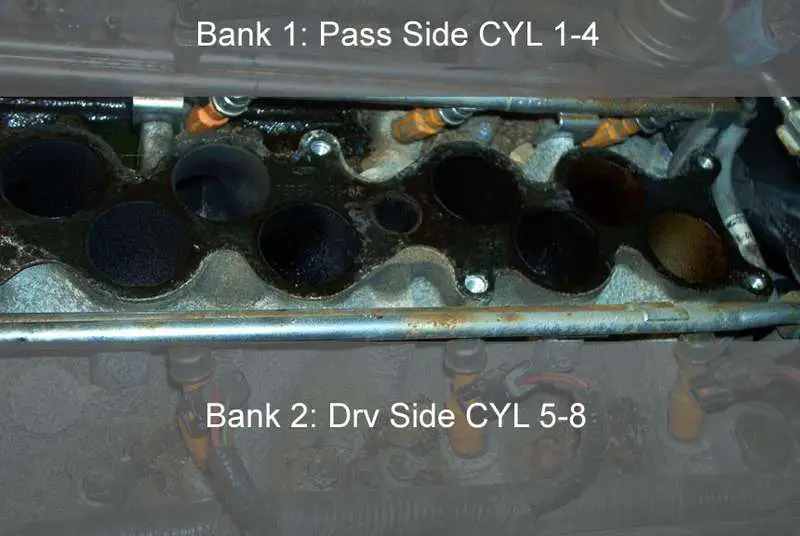

I just finished pulling off the intake, and found some interesting results in the form of the "coatings" inside the lower intake runners. Cylinder 4 and 8 were very clean, a shiny gold color. Cylinders 1,3, 5-7 were a shiny black sludge. Cylinder two was a dry black, with some clean aluminum showing. I had just run some Sea-Foam through the brake booster hose.
Why was cyl #2 dry? Could this confirm the sticking valve theory?
Here is a photo of the lower intake:
Good thought process. Certainly the Seafoam (composed of various alcohol components that essentially digest built-up carbon) might confuse visual findings, but the #2 cylinder injector might just explain it. If the injector is the final answer, then that would be great! (in comparison to pulling heads, redoing valves, etc.) And seafoam through the vacuum hose might just have unstuck the valve. I'll be interested to hear your findings.

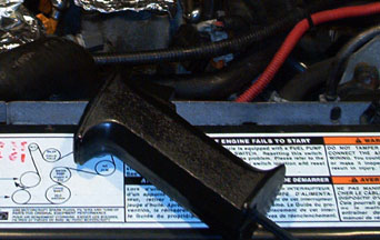

Removal of V8 Upper Intake:
Hood Clearance anyone?
