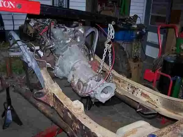

Removing the crossmember lets the entire assembly droop -- in my picture, imagine letting the hoist lower -- everything tips to where you can see it from the rear and get on the bolts with a long extension.
